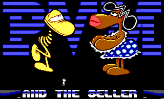

I tested the intro on another machine (something that I should have done before releasing it) and it looked like this:
does it look like that in your machine?
From the raster bar noise, I can tell that the 2nd machine is one or two cycles slower per raster line... something that I should be able to fix, but I should do it in a way that works Ok in all machines.
Perhaps my 1st machine is using a NEC v20... if not, I wouldn't know... perhaps one of the side-carts is inserting an additional wait-state?

Sidecars don't add additional waitstates. And yes, my corruption looks like your photo, so if you fix it there, you'll likely fix it on mine.

I tried the demo on my PCjr and got the tearing pictured above. I also had to do a clean boot off floppy with just jrconfig.sys in DOS 3.3. My normal boot also includes drivers for network, 3.5" backpack drive, and serial mouse, and one or more of those causes the demo to hard crash after 15-30 seconds. I've still got the stock 8088, plus jrIDE, speech sidecar, and the devices mentioned previously.
