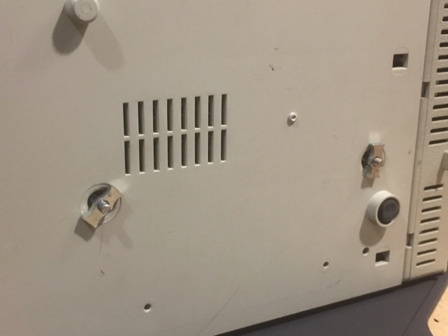

Most of my JRs don't have the floppy drive sled held in place right because the tabs on the ends of the legs are broken. How do you handle that? I broke off the little that was left and found that a #8 x 1/2" screw fit nicely in the hole and I was able to tighten it enough that the drive sled doesn't move. I am wondering if there is a better way though.

I use a screw and a long nut. Just make sure the screw doesn't stick out past the feet on the PCjr.

That looks VERY secure, but probably somewhat harder to do. I will have to see if I can find parts to do that. a regular nut with a wide washer would probably work well too.
