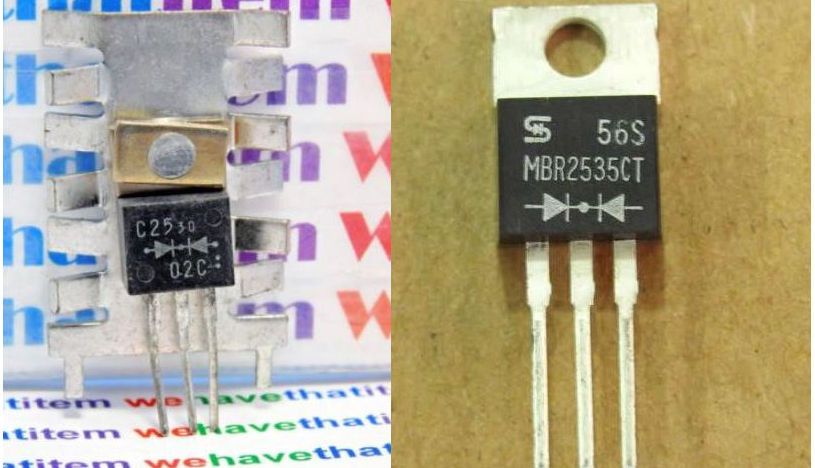

I removed both Schottky Diodes and tested them with a meter (no load) and they both tested good.I am not sure if they are different from each other electronically or just made by two different manufactures. If the latter, then maybe one was replaced before. I have since reinstalled them.Chuckphd53 wrote: Now your comment about the 110 v drop tells me that the switching is not working, this means there is most,likely a bad transistor, and it is probably one of those with the large heat sinks.

Looks like the original are 25A and the new on is 30A this is fine....
Sounds like you tested them and they are ok simple diode type test with the meter...
