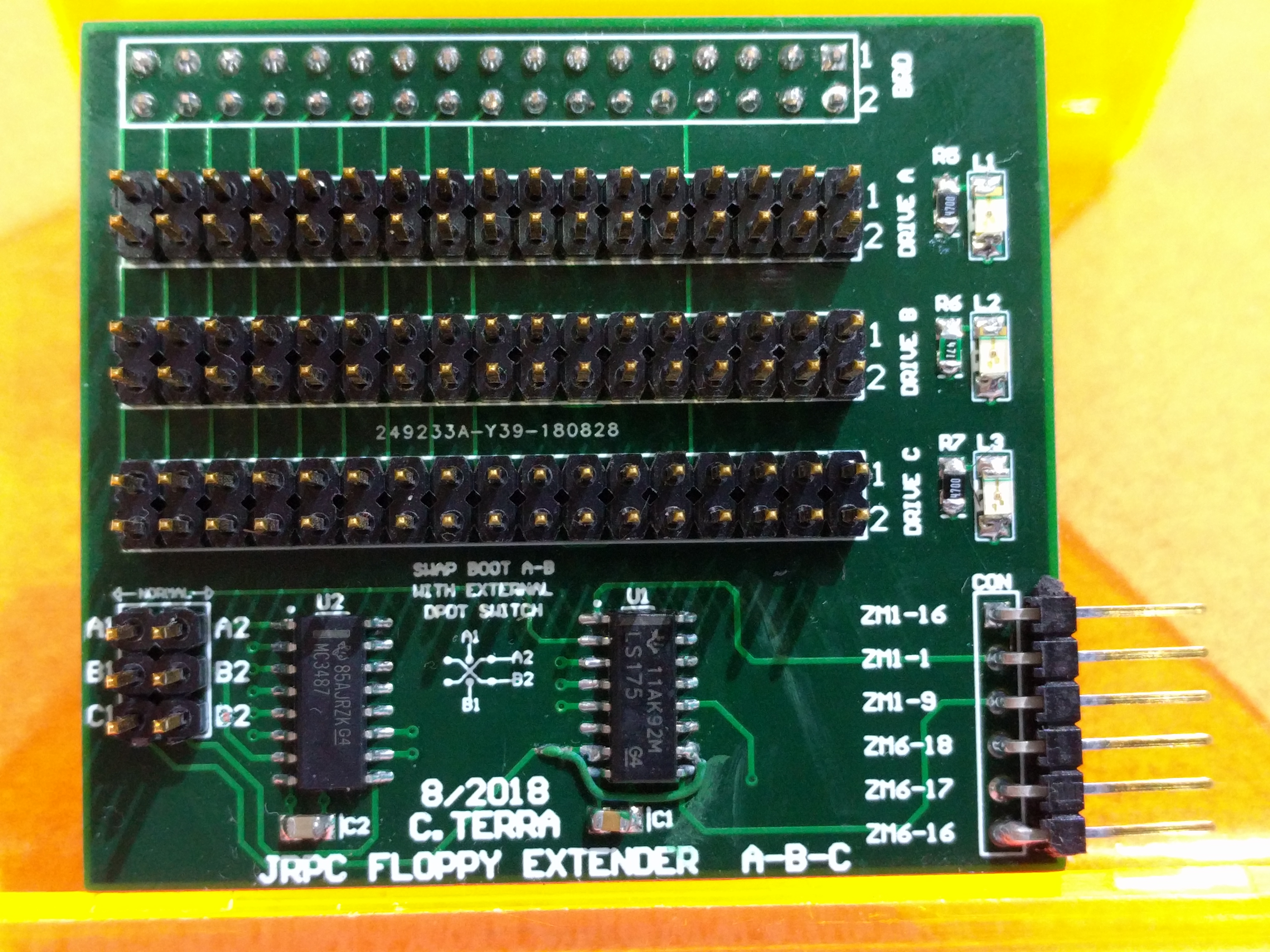

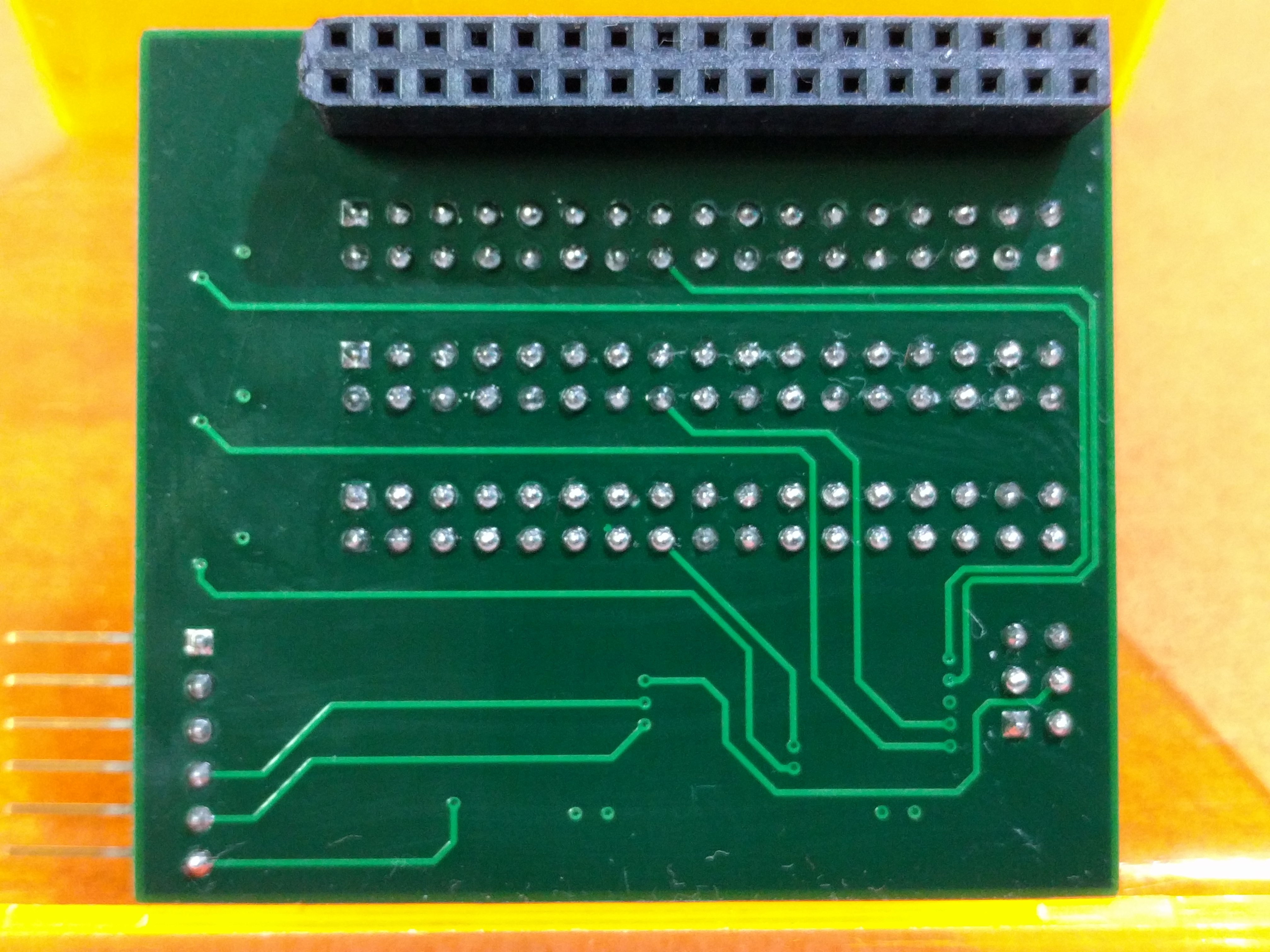

Also I have mentioned my 3FLOP board that allows you to hook up three floppies...
Not: the board had one 'woops' had to do a jumper wire..

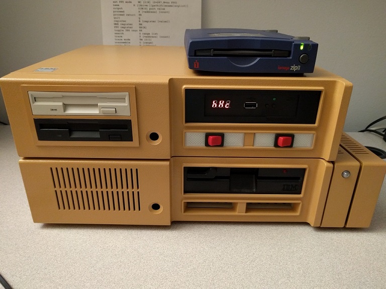

The last pic shows my home JR I work with,,,,have gotten some 'looks' on the color, but it is my work unit and it looks better in person
also the top unit is just another JR main case that I cut drilled etc to fit on top.
Quick description...if you are interested...
there are basically 4 drives counting the USB unit.. using the 3FLOP board..
I get there buy just adding a DPST switch to the SELECT line on the floppy and choose which I want to deal with
I also have a second DPST sw to change 'who' is the boot floppy, it selects 5.25 drive of one of the 3.5 drives....
but usually I have the JRIDE (shown on side with LED Lamp) as C: drive boot up...of course..
Also is the typical Zip drive most folks have...
You cant see it but the top unit uses an internal switcher (Mouser Elect about $20 see pic), with 3 voltages that cable down to the main board for power and a single power cord connector on the back, NO MORE BRICKS...
NOW the last picture is my COLOR JR......
So you are not completely taken back by my painting the Classic JR...I have 3 pristine units in boxes that are untouched !
ON the BACK picture. you cans see some switches, the two sw in the box are the PCJRSPRINT ON/OFF/ RESET
and the bottom BLACK button is for the TANDY video ON/OFF Push button..

I've been following your discussion on your 3flop board Chuck. (In this thread and others.)
Looking at the schematic, if I follow it right, you can use jumpers (or a switch) to change the assignments of up to three floppies. Do I have this right? For your Kings Quest copy, you did this without rebooting, right?
I'm thinking about adding a Gotek emulator to my jr and would love to be able to swap A: and B: between the 5 1/4 and Gotek depending on need. What software do you need to enable this? jr config?

I am surprised I never thought of turning a main JR case into an expansion chassis. I have a spare PCjr that I accidentally fried the motherboard on and never got around to troubleshooting because someone here was kind enough to just send me another one when I mentioned that happening, and I've done a 2nd floppy drive mod on my machine, but just have the bare drive sitting outside the case. I can't believe I never thought to gut the case of the broken machine and stick that 2nd floppy in there. I might have to look into that soon.Chuckphd53 wrote: The last pic shows my home JR I work with,,,,have gotten some 'looks' on the color, but it is my work unit and it looks better in person

take a look at the attachments on how to hook up a DPDT switch to toggle (Physical Drive A) and (Physical DRIVE B) as the boot drive (A)
I have plenty of the 3Flop boards but I do have to make a jumper as I goofed on the layout, but a couple jumpers fixes it.
(you can see a green wire in the pics) I conformal coat over the the jumpers to keep them in place.
WIth multiple DPDT switches you can make an elaborate BOOT DRIVE A scheme as I have, I can boot from 5.25, 3.5, USBGotek.

As for the Top case, If you look at the front, I cut the GRILL portion off and 3D printed a frame and an internal drive holder.
I will offer to print these pieces for the jr Folks, but please give me some time to get this done usually takes a day to print the parts...
Also I printed the holders for the DPDT switches ( this is where the CART's would normally be) I've attached the DPDT switch I bought from MOUSER.COM
These are just press fit and tight enough to say with no issues.
My next Task is to place another Jr Case on the top and include a Second 5.25 Drive, as I find it would be nice to have this as (Drive A-5.25, Drive B-5.25)
which back in the early days of the Jr would have been the normal setup we had, and easier to copy 5.25 Floppies...
I just need to find an ebay junker to tear down, seems lately they are a bit pricey....

COPYIIJR A, A
but I also make copy to a 3.5" (my B drive)
COPYIIJR A, B
and I first had to format the 3.5" as a 360K floppy, no problem as it is just for saving an extra copy on 3.5" (my preference)
Be sure to boot with NO DEVICE =DRIVER telling your system that Drive B is a 3.5" 720K disk.
also JRCONFIG should be setup for two drives as you normally would !
just makes things more convenient.
Oh as a side note: I use Fabuloso cleaner from Home Depot to clean and de-grease the cases/ parts before painting, and it was a fantastic choice.
It removes the dirt and grease great !
NOW ! I KNOW, the color sucks, but if you saw it in person you would like it
and I found it is such a nice neutral color, it was my favorite choice for this setup.....Heck my wife is a crafter / painter and she said one day
that 'that color was a good choice' got a crick in my neck when my head spun around to look at her ! she was serious ! wow ! but I digress...
