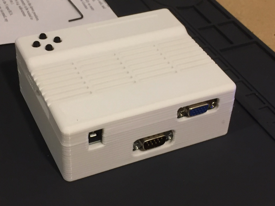

I have 2 PCjr monitors for my 4 PCjr units and had been interested in utilizing a VGA monitor when I saw this thread. But the cost to purchase a C128-DAC, Gonbes 8200 board and a nice 3D printed case was well over $100 ... and that made me reluctant to buy. So I put these items on my Christmas list and my brother-in-law bought me everything!

Those Gonbes units are not that great, they are rather noisy line doublers and require the CGA2RGB DAC. This is a superior solution : https://youtu.be/9SII7ujB3FY
The ideal solution for a modern LCD is the Open Source Scan Converter (OSSC) combined with the GCLabs CGA2RGB DAC.
