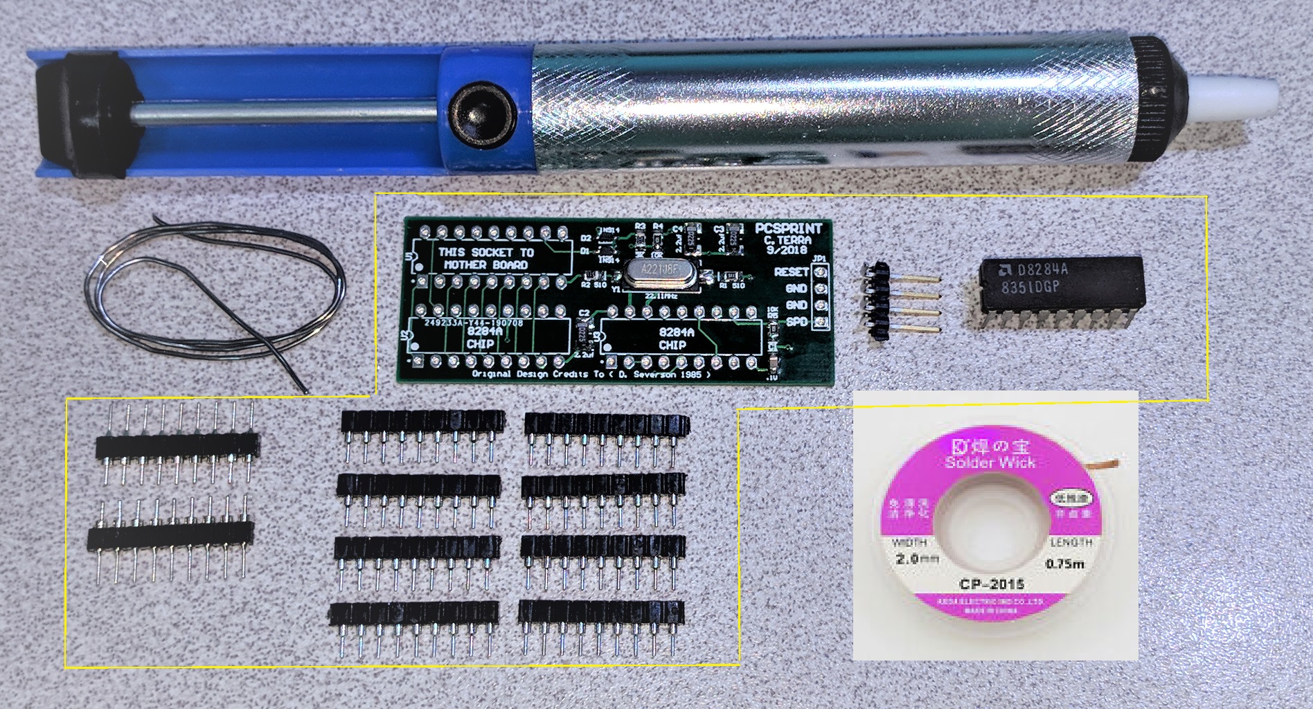

I have 5 kits I can ship.
I know there are a few more folks that want this for their Jr's....so they will come next...
Below are links for the pictures, if the attached is not shown fully on your screen...Please refer to these...
Included in THIS kit is the SPRINT parts but also has a solder sucker, wick, and some solder.
The solder sucker and wick can be bought on EBAY from china from about $1 each if you want these yourself.
I only wanted to offer a few for the folks that don't normally do this kind of work and do not have these on hand.

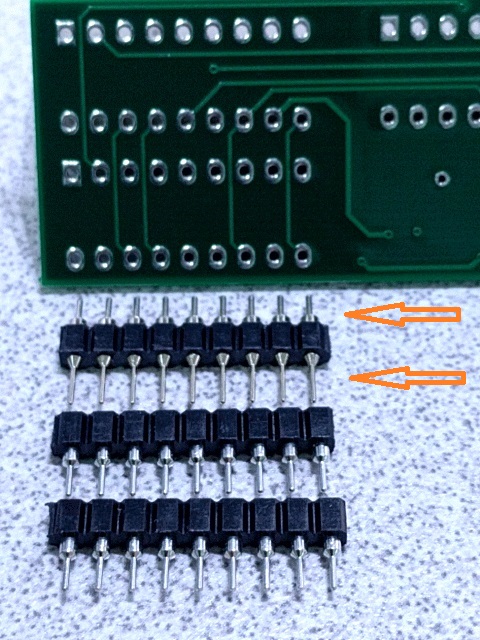

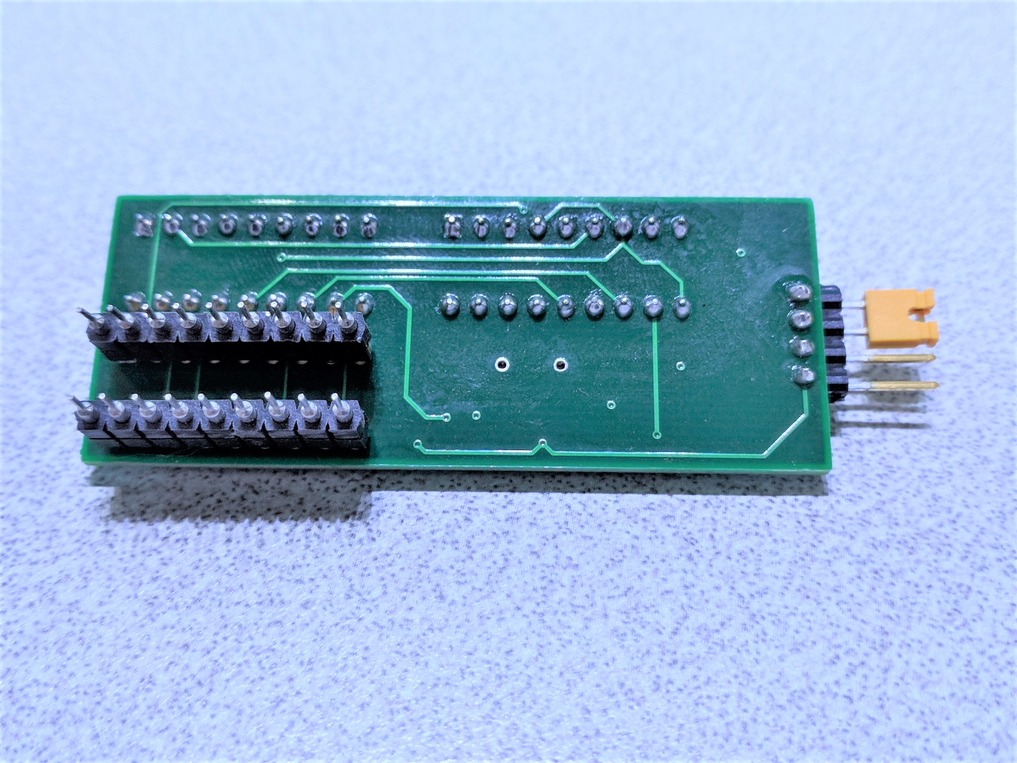

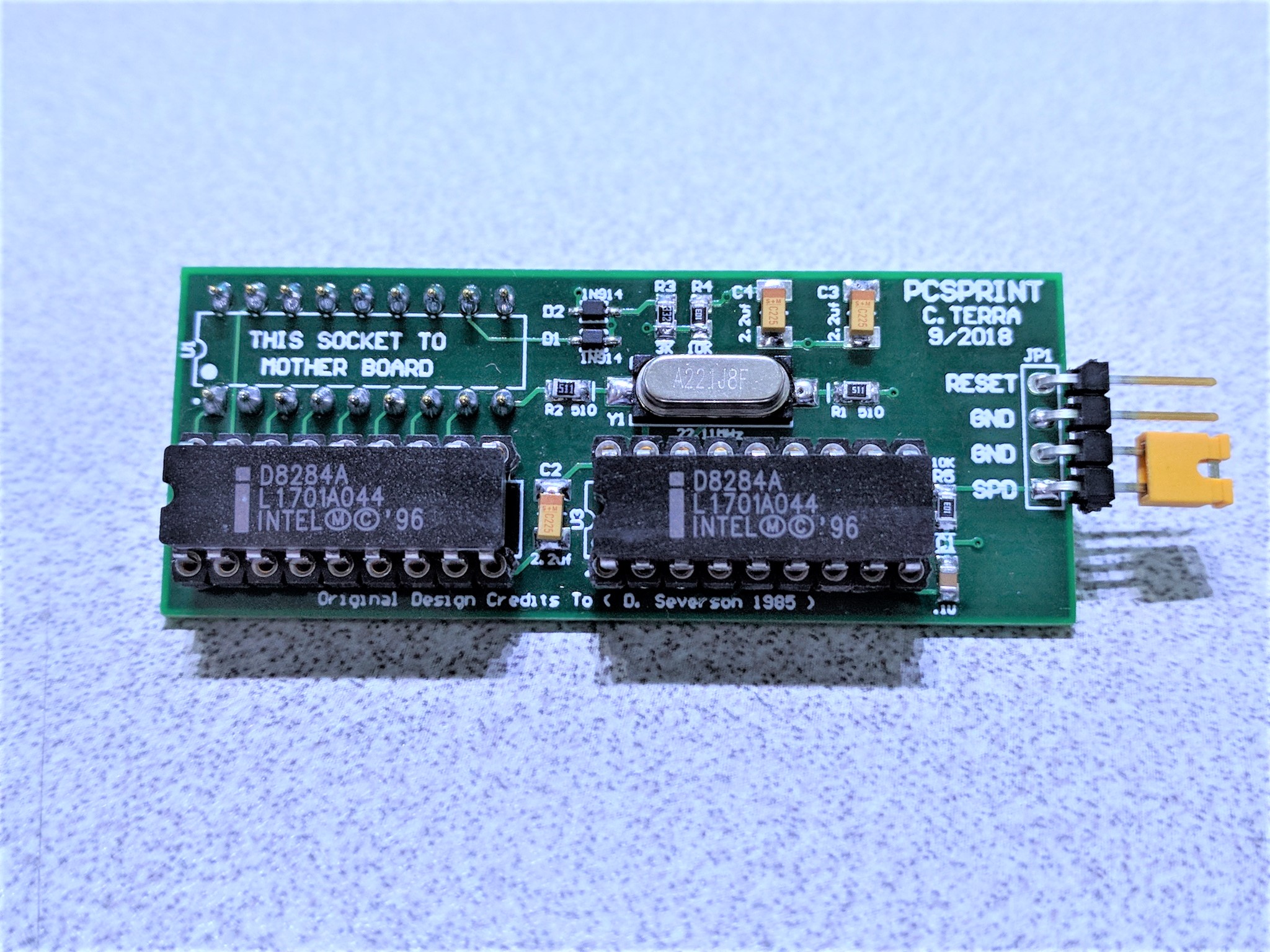

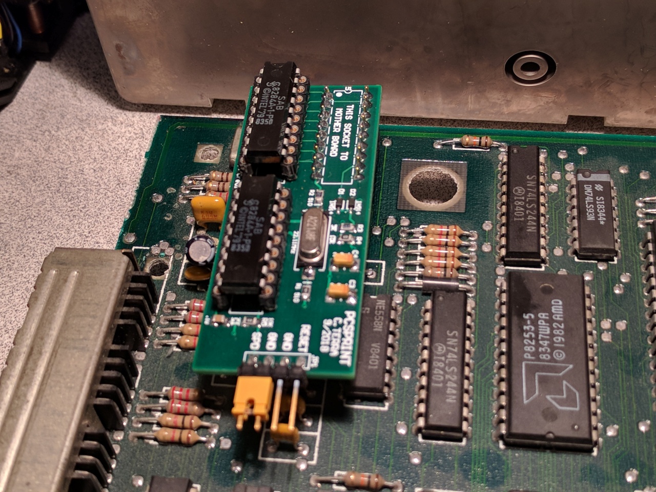

All the boards will have the surface mount parts attached, the only thing left would be the headers/connector.
You will need to remove your Jr's8284 chip and reuse on this board. 1ea. 8284 chip is included for position U3 on the board, your MB chip can go in position U2.
There are 2 ea thru hole male to male headers that are used in position U1, the short leads will be soldered to the bottom of the SPRINT board so it can be plugged into your PC Motherboard.
SEE bottom picture of stacked connectors:
The longer thin lead will plug into the headers supplied you will solder to your MB after you remove the MB 8284 chip.
I have included an extra set of headers to use on the MB to help lift the board a little higher.
The other headers you can use to solder to the top side of the SPRINT brd and 'PLUG' the 8284 chips into.

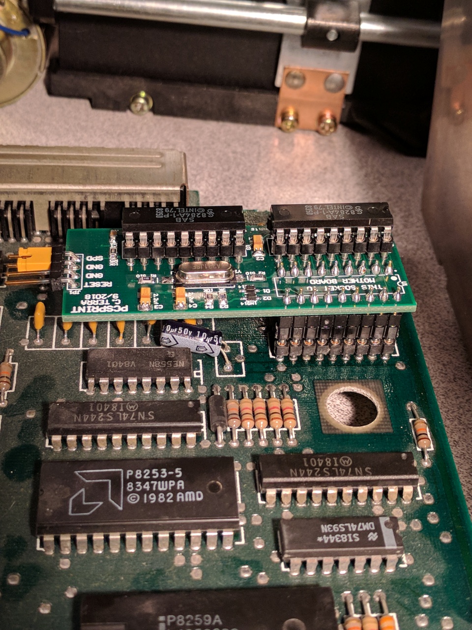

One Item you will find during this install is there is a small can electrolytic cap soldered near the MB 8284 chip, it stands proud of the MB and kind of gets in the way of the new SPRINT board.
If you look at the bottom of the MB at the cap leads you will see there is a little extra lead protruding thru the MB .
Using your solder iron heat up the two cap leads from the bottom side of your MB and pull the cap out a little, this will allow you lay the cap on it's side lower to the MB and keeping it away from the SPRINT board bottom side.
On my board I just removed it and soldered it to the bottom of the MB, BUT, BUT, BUT if you do this make sure you NOTE which leads go in to the correct holes as this is a polarized cap and it does matter !
TAKE PICTURES WITH YOUR PHONE FOR REFERENCE!
