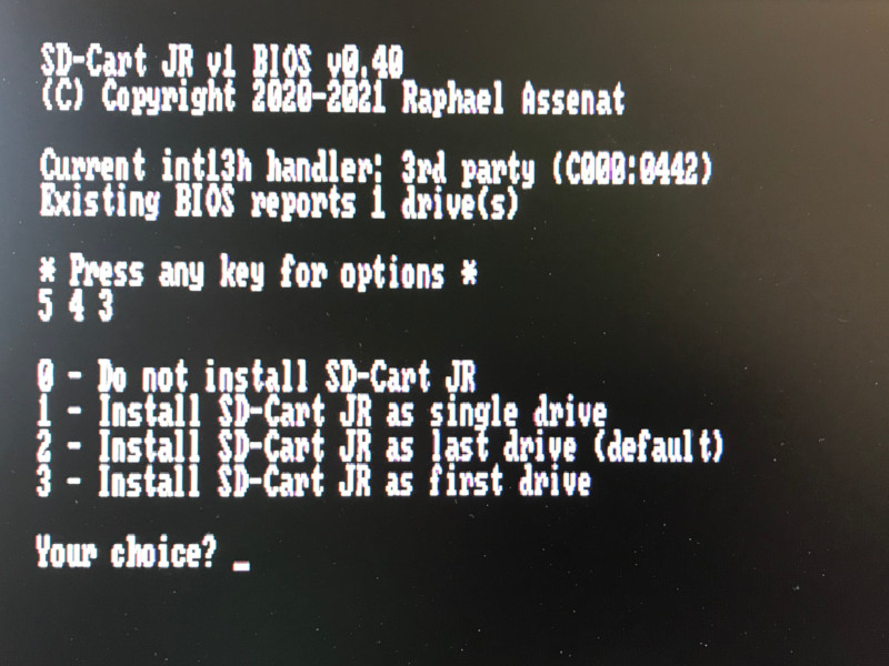

jscrow wrote: I tested the boot ROM on my jr-IDE system: the SD-Cart jr boot ROM has priority. Boots to jrIDE BIOS screen as usual then directly displays SD-CART jr BIOS screen and boots to the cartridge. It apprears that the jrIDE hard drive is not recognized as it is not assigned a drive letter.
Hmm.. That's not what I hoped would happen. I wanted the SD-Cart JR to be C:, and the jrIDE hard drive D:... Anyway, I sold enough to finally buy myself a jr-IDE, and it has just arrived (I will have more than 256kB of RAM at last!). So I should figure this out and release a new boot ROM soon.

The new version of the boot ROM now works with other hard drives (tested only with jr-IDE). An option menu has been added to the boot screen, to allow different scenarios (Install SD-Cart JR as first drive, last drive, sole drive...).
