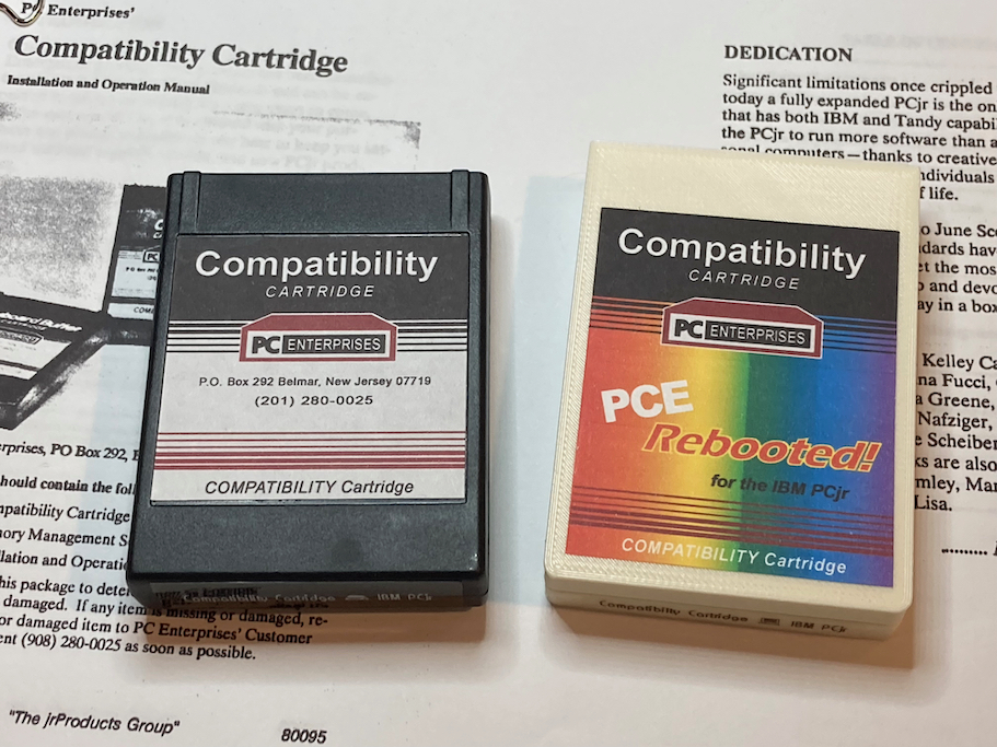

I made another to factory specs and now have two! As you see in the picture, my wife got creative with the second label on the white 3D printed shell :)
