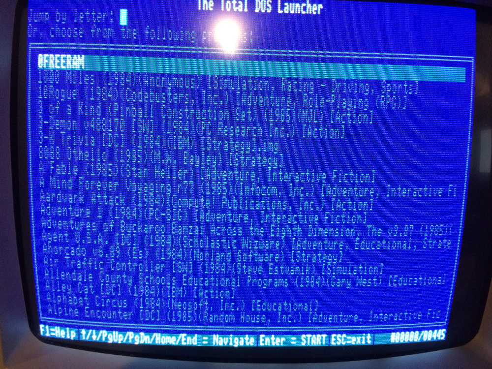

1. The menu is hard to read. The text (at least on my PCjr) is light gray on dark blue.

The text is indeed light gray on dark blue but that shouldn't be hard to read... My PCjr monitor looks like this:
( https://goo.gl/photos/SfBhPXhDmcNZLaxe9 if it didn't show up inline above) Does your monitor look like that? If not, calibrate it. If so, and you just don't like the color scheme, that's fine -- I'll add a feature to change colors. Until then, you can use MODE BW80 to set the system to B&W mode and it will use the monochrome color scheme.

The gray on my monitor looks a bit darker. Maybe my tube is going or something? The picture below is very washed out looking unfortunately:

Tempest wrote:The gray on my monitor looks a bit darker. Maybe my tube is going or something?
Have you tried going into the diagnostics, showing the 16-color pattern, and making sure your brightness and contrast controls are set correctly?
Also, why/how is your font different? That is a thinner font than the actual PCjr font. You should only use the CGA "thin" font on very high resolution displays; the PCjr monitor has a really fuzzy dot pitch so you should use a thicker font with it..

It's the PCEnterprises Thin Font module. It's made for a PCjr so it should be safe.

Yes I can use the thicker font to make it a little easier to read the TDL menu. but I think it looks ugly for regular DOS use. Is there a way or future plans to change the colors on the menu? Like white text on a black background or something?

If you type MODE MONO before starting, you'll get the black&white color scheme. Use this until I can add custom colors to the TDL.INI file.
