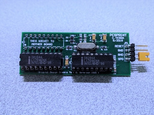

I am going out on a limb here, but spent the better part of the day reviewing the original Sprint design, and I think I may have found an issue.... Not willing to say for certain, I need to do a ground up design to see if I am right. Also need to find a complete data sheet for the 8284 chip.

OK i am satisfied that the original Doug Design is good and my layout is ok..
I am getting a quote for boards then will get a batch and build up a few...
I also have a few V20-10 chips that I want to try a higher crystal, just to push the limit, and see how stable it is..

bagelswitch wrote:My board _just_ clears the drive support leg in the front, the fan shroud in the back, and the side of the case on the right. There's really no other way these components could be placed above the the existing 8284 location without obstructing anything, so that's what I did. I followed the Severson schematic exactly, only swapped the part locations in the physical layout (and let Eagle figure out the trace routing, I'm a novice) - I'll share the schematic and layout files I created somewhere later this weekend.Chuckphd53 wrote: (Below is a picture of Bagleswitch's PCSprint board install from an earlier post, this shows the hole in the mother board
that the DiskDrive plastic leg snaps into the hole
SO: the only way to install the original design for the IBM515x is to use the IC1 position with headers.
Eagle layout: https://1drv.ms/u/s!AqVrKLbX9W2f33vPB8P ... V?e=QcGFlG
Eagle schematic: https://1drv.ms/u/s!AqVrKLbX9W2f33ydk-I ... 9?e=1RAF56
Gerbers (these should work as-is at PCBWay): https://1drv.ms/u/s!AqVrKLbX9W2f33qoZON ... r?e=5ZHOYT

The new PC-SPRINT boards came in, I will be testing it this weekend and give a report on how it is working..

Ok here is the testing results using TOPBENCH test tool
Basic system w/ sidecar 512K mem
DOS boot V4.0
8080 Processor Original
Sprint OFF Score 4
Sprint ON Score 6
V20-10 Processor
Sprint OFF Score 5
Sprint ON Score 8
So it looks like a success.
I Still want to try a larger Crystal with the V20 chip, I will try this next week.

I used my solder sucker to get the 8284 chip out, and still had to work it a little to free it up...just FYI.

YMMV of course, but with my boards I haven't had any success above 8MHz (using a 16MHz-capable V20).
With any crystal I tried faster than 24MHz, the system will cold boot, and even run topbench, but anything that involves much disk or memory access results in a hang.
w/ a 24MHz crystal, things are rock-solid.

What flavor V20 are you using ?

Also, only the 8284A1 can be used for the V20-10 the 8284's pulled from the Jr won't handle the higher speeds..

Your Mileage May Vary . . .
And yes, I'm using 8284A1 clock generators for attempts above 8MHz.
The V20 I'm using is a D70108HCZ-16: https://www.alldatasheet.com/datasheet- ... CZ-16.html
